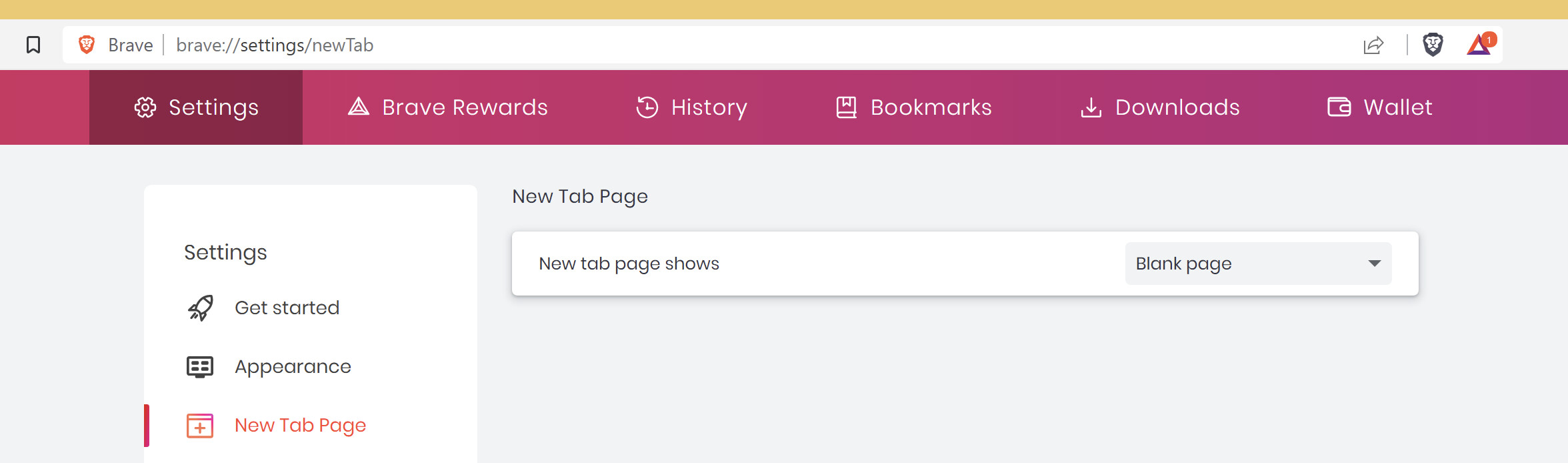

@stanger @keyopp Would you mind trying to use airplane mode/go offline, go to brave://settings and set New tab page shows to Blank page manually? Then turn off airplane mode/go back online and try opening Brave.

Just tried via brave://settings, didn’t worked either. Re-launched browser with logging on, same info:

Actually, the first set of steps (where you set the shows_options setting) is not necessary, as once you opt out of Brave News, it doesn’t matter what you have the new tab page set to (i.e. can be dashboard).
