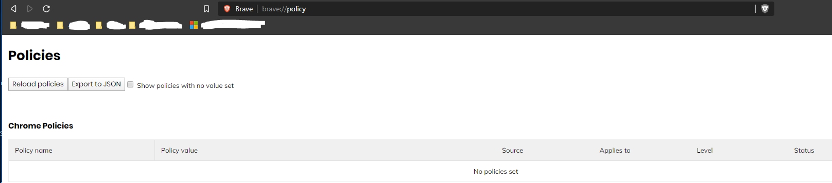

I have “AuthNegotiateDelegateWhitelist” and “AuthServerWhitelist” REG_SZ entries in HKLM/SOFTWARE/Policies/Chromium and the Brave browser is not recognizing them. I am able to successfully set the --auth-negotiate-delegate-whitelist and --auth-server-whitelist flags though.

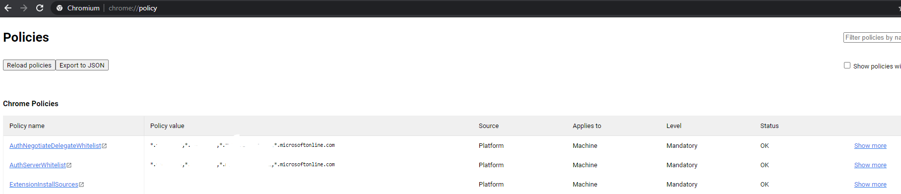

I’ve installed Chromium to see if I was just crazy, but it is able to pick up the entries and properly set the policies. I can go to brave://policy and it shows as empty, while going to chrome://policy in Chromium will show both policy entries.
  1. Fresh install of Brave v1.4.95
  2. Add “AuthNegotiateDelegateWhitelist” and “AuthServerWhitelist” entries to HKLM/SOFTWARE/Policies/Chromium
  3. If Brave is running, restart application.
  4. Go to brave://policy
Policy entries are not being recognized at application start
Result is that Kerberos auth isn’t available unless startup flags are set in application shortcut.
Expected result:
Screenshot added from Chromium (dev build 82.0.4072.0) to show expected entries

@jonastio,
After the update to v1.4x, the correct registry path is no longer the same as Chrome/chromium. You should be looking in 1.
HKEY_LOCAL_MACHINE\Software\Policies\BraveSoftware\Brave
Added entries to the path supplied. Was picked RIGHT up after clicking the “Reload Policies” button under brave://policy. Was this change documented anywhere? I tried looking at the release notes and the support site but was unable to find anything earlier.
