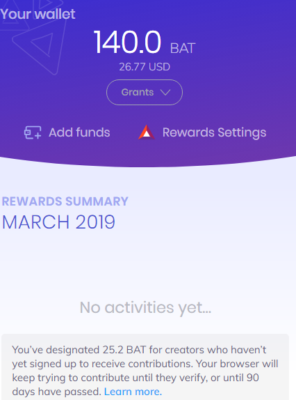

Receive message : “Your scheduled monthly payment for Auto-Contribute and monthly tips could not be completed due to insufficient funds. We’ll try again in 30 days”
But I have 140 BAT in my wallet, and the auto-payment is just set to 30 BAT. This has happened to me several times, now (over the span of several months).
just wait until auto-contribute date, and check the Rewards screen
brave-insufficient-funds
