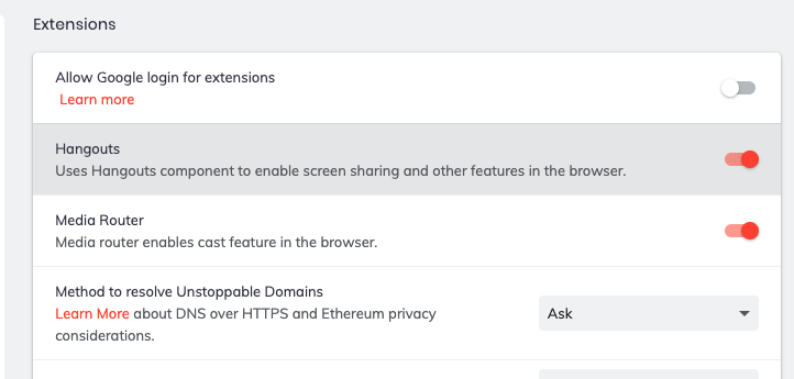

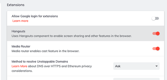

I checked all the recommended settings (which all were enabled by default) other people have posted here but still can’t use the microphone (in the beta version, as I can’t have two different versions of Brave. But I did try in the stable Brave version as well, and they can’t hear me/or use the microphone in browser. I am just using beta so I don’t have to install/uninstall all time)
Yea, unfortunately I tried all and still nothing. It’s strange that in v1.25.70 it works, but in any version after that won’t. I don’t know if it’s affected by the Windows version or something.
