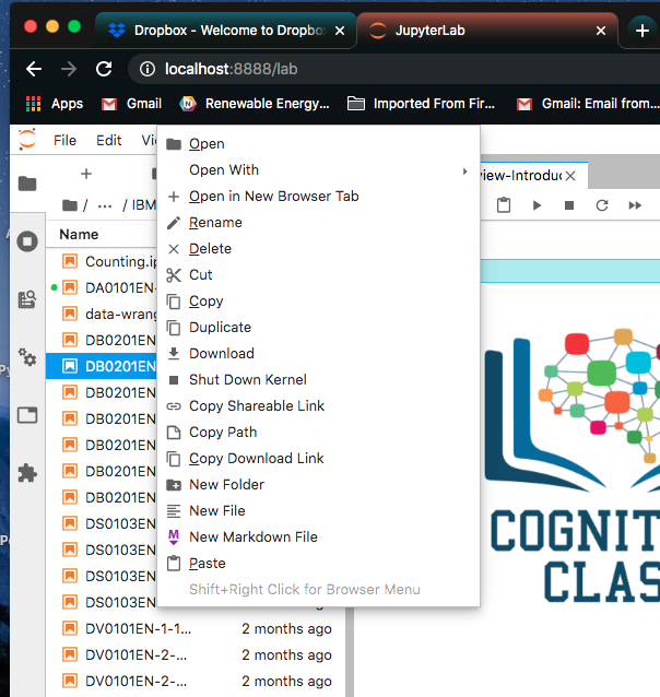

I use JupyterLab for some of my Python coding. This program opens a tab in the browser that uses as the display interface. I had used it a month or so without any issues, but about a week ago I tried to use it and I noticed that the JupyterLab loads properly with the exemption that some of the contextual menus do not show up. Only this weekend I had some time to try to check the problem in more detail and as a first step I reinstalled JupyterLab and the issue persisted. After I decided to try with other browsers (Chrome and Firefox) and both of them have no issues and show the menus.
I am attaching three partial screenshots showing what Brave, Firefox and Chrome display if one of the files is selected in the file manager and the contextual menu is requested. Brave produces the contextual menu for the tab generated by Brave while Chrome and Firefox display the expected contextual menu produced by JupyterLab.

As per your suggestion initially, I updated Brave to the latest 1.15.76 (thanks I thought I had the latest…) but this did not solve the problem. After, I went to check if any of the extensions was the problem. I had thought of this, but I was lazy to do it because I have way too many extensions. Well after some testing, it turns out that the problem was one of the extensions, “Open with Soda Player”.
This is an extension associated with the app “Soda Player”, which as the name suggests is a video player. After checking its website and the extension webpage, I confirmed to have the latest versions of both, which were released a couple of years ago and since then the developer has not provided any new updates.
So justsomeone1 thanks for the advice , it has resolved the issue and provide me with a way around it, to disable the extension. However, it is curious that I have had the extension for several years and before there were no problems and not conflict with Brave. Hence, something has changed in Brave recently that ignite this. I understand that maybe things have changed and the extension has not been updated accordingly.
