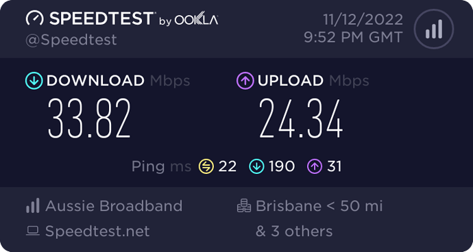

Speedtests done on Brave show 30Mbits (not 30 MBps), other speedtests show 800 to 900 Mbits in download speeds achievable.
I have reset NIC on my device.
Removed QoS from router.
Checked Brave on 3 other devices in the house all show good results in speedtest.
Reset Brave to defaults before uninstalling it.
Uninstalled Brave on the problem device. Removed all settings, reinstalled.
Speedtest from Brave on problem device
Speedtest taken on Brave on correctly working pc:
All tests above were conducted using cat6e cables linking to devices at gigabit speeds.
Slow speeds also experienced on problem device when using wifi (its a laptop)
Speedtest on problem device using Brave over wifi:

Firewalls havent been changed, but for sanity check I turned off the laptop firewall and tested Brave again.
No difference.
Brave speedtest is stuck at 30ish Mbits, all other browsers get upwards of 200Mbits.
Extensions were disabled in the initial fault finding process.
I then uninstalled Brave, removed settings, deleted “user data” folder in.
C:\Users\xxxxx\AppData\Local\BraveSoftware\Brave-Browser, then reinstalled Brave and did test with stock standard install. No change, 30Mbits again.
I also downloaded Brave Beta, and the same issue is present on the stock install of that.
The device I am having the issue on is a Dell Precision 3550 laptop, less than 12 months old.
Just to make it more interesting, if I enable a VPN on the device the Brave speedtest gets normalish speeds along with the other browsers.
If I enable browser plugin only VPN, the speedtest gets 30ish Mbits again.
