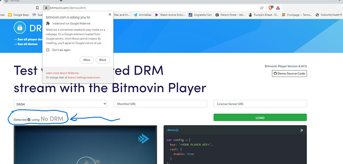

I’d advise you to check out https://bitmovin.com/demos/drm and see if it shows that you have your DRM active. If it is, then it will look something like:
If it’s not active, then you’ll instead see something like:
Of course, because it thinks you don’t have a DRM, it will offer to install it. You can ignore that prompt.
Assuming you have Widevine on and that site shows you with DRM, then you know that’s not an issue. The next step(s) would be for you to try to disable extensions and/or to create a new browser profile and test it there.
