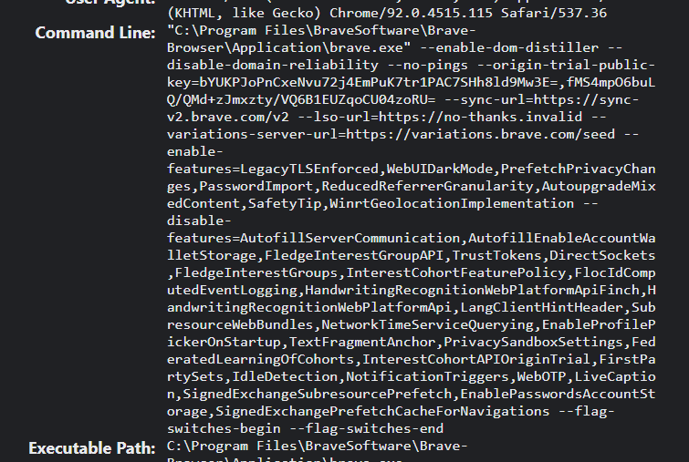

Because the software works better in Chrome than in Brave, could you provide screenshots of the about://version page from both browsers? I’m primarily interested in the “Command Line” portion, which looks like this:

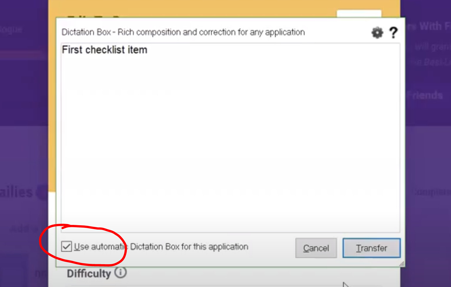

Lastly, I was curious about Dragon’s own settings. I noticed when you were dictating input into the pop-up box, that Dragon was configured to Use automatic Dictation Box for this application. There was also a :gear: icon at the top-right; can you explain these settings, and share what other settings exist for per-application interoperability, please?
