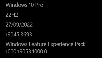

Well after updating Brave for like months without updating it, it just doesnt launch anymore, no process, nothing. The only way to launch it is using the compatibility mode.
Also I cant open new tabs or anything Im stuck with my old tabs (probably because its in Windows 8 compatibility mode)
I found the issue, apparently if u had launch as administrator by default it doesnt launch any process, but if you untick the option and launch it without administrator it works, also with right click and launch it with administrator it works too.
