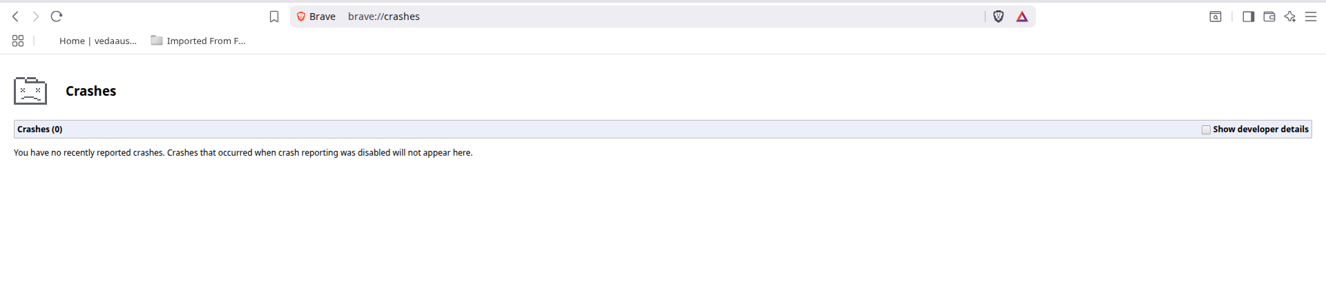

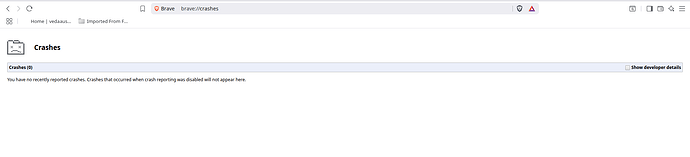

Hello! Do you have any available crash logs at the time it occurs? They can be found at brave://crashes
Unfortunately, nothing there, see screendump
@jehoshua7 typically if it’s the browser crashing then it should trigger a crash report. If you’re not seeing it, then it can sometimes be a clue that perhaps something else is interfering.

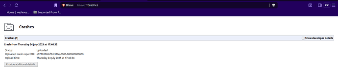

@Saoiray - I was able to upload a crash report from today.

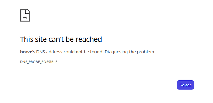

@289wk , when I use those parameters, a get an error message as follows:
This site can’t be reached
brave’s DNS address could not be found. Diagnosing the problem.
DNS_PROBE_POSSIBLE
Posibly related ? - This site can’t be reached community.brave.com’s DNS address could not be found. Diagnosing the problem. DNS_PROBE_POSSIBLE

Re the DNS cache, maybe I now have to disable the private window setting ? This is what I have tried:
sudo resolvectl flush-caches
sudo resolvectl statistics
plus deleted the Brave cache path, but no difference, I still see the DNS cache msg each time I startup Brave.
The DNS error message only happens once, when I startup Brave. It doesn’t happen for any websites, all there is at the URI site address bar up the top is:
http://brave/

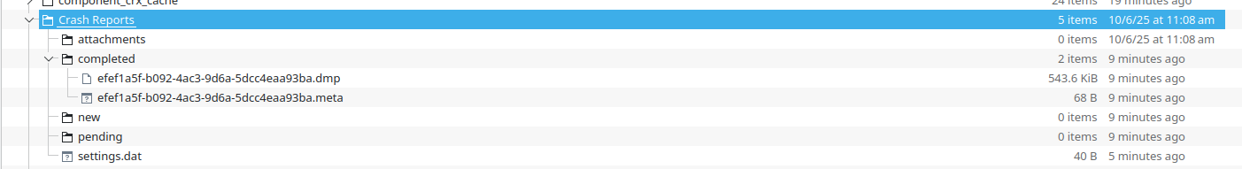

The crash files are shown in this screendump
I have taken a backup of the two crash files, if they are needed.

When I access brave://crashes , this is what I see:
I was logging into facebook this morning and it crashed. The brave://crashes/
Crash from Tuesday 29 July 2025 at 07:13:42
Status: Uploaded
Uploaded crash report ID: 9c0c0f00-bf2d-370e-0000-000000000000
Upload time: Tuesday 29 July 2025 at 07:13:44
The files in the Brave Crashes/Completed path are:
8b354bb5-8c52-40c0-b0cb-ef0888392db4.dmp
8b354bb5-8c52-40c0-b0cb-ef0888392db4.meta
