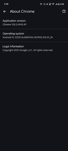

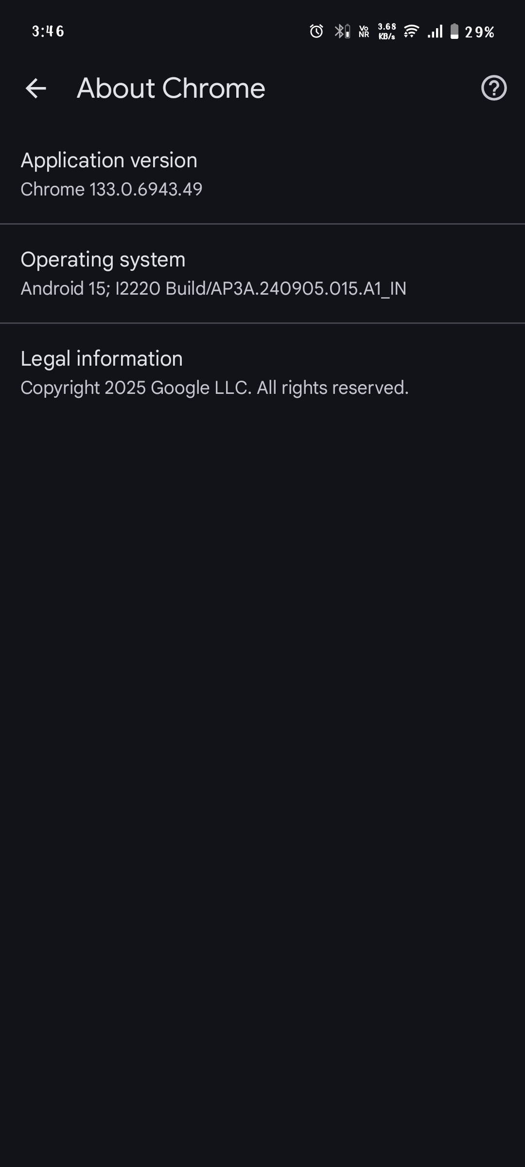

Chrome app details:
App version: Chrome 133.0.6943.49
OS: Android 15; Build/AP3A.240905.015.A1_IN
Hope it helps.
