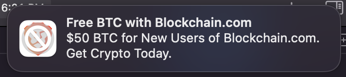

Description of the issue: When receiving a notification on the latest Brave ARM update, there is no icon in the notification display.
Receive notifications
Expected result: Supposed to see a Brave browser icon in the notification

@soccerjoshj07 ,
Just to confirm the behavior here – notifications from Brave appear as intended, but Ads notifications specifically work but don’t have the Brave icon displayed, is that correct? Can you also tell me what version of macOS you’re using?
Yes, ad notifications appear but they don’t have the Brave icon displayed.
macOS 11.6.2 - can’t upgrade to 12 yet b/c of work policy.
I did just recently upgrade from like ~11.2 or 11.3 to 11.6.2 last week or so now that you mention, so that could have caused it too?
Perhaps – I’ve pinged the ads team to check and see if they have any idea why this might be happening.
Looks like we’ve logged an issue for this here:

## Description
Brave icon has a cross through it in ad notifications upon updating to macOS Monterey (12.0.1)
## Steps to Reproduce
1. Update to macOS Monterey
2. Turn on Brave Rewards
3. Wait for ad notification
## Actual result:
![image](https://user-images.githubusercontent.com/50230324/138887207-ed010fc0-ab05-4a91-a9d5-d2f6ff010a3e.png)
## Expected result:
Brave Icon is normal

I just got a notification from a website that I turned on notifications for - and it also didn’t have an icon - so not necessarily all “ad” related (contrary to what I had before with Gmail - the notification type is different it seems)
@soccerjoshj07 ,
Thank you for the information – I’ve included this report/info in the issue listed above for our developers to review.
Looks a little different now that I updated to macOS 12.1, fwiw
