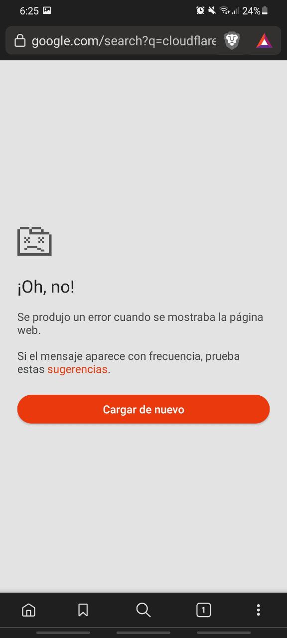

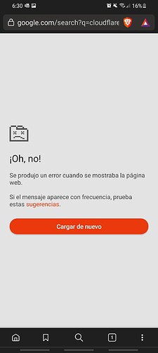

The FIRST screenshot is good: a valid Google Search result for search criteria ‘cloudflare’ . . . but:
Translation for the SECOND screenshot - thanks to ‘deepl.com
An error occurred when the web page was displayed.
If the message appears frequently, try these suggestions (link undetermined because of screenshot).
Reload again
From the 1st screenshot it automatically passes to the 2nd screenshot in milliseconds

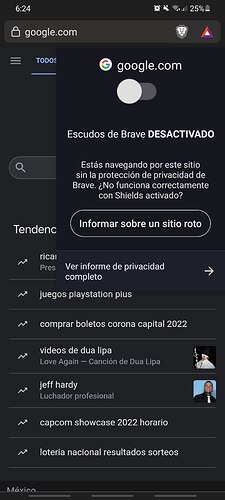

  • If the issue occurs if you turn Shields down for Google.com?

Turning Off Shields - Same situation

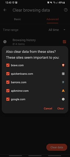

Nightly is the most likely build to have errors and issues so things like this are expected. Can you try clearing your cache and site data and test to see if this resolves the issue?

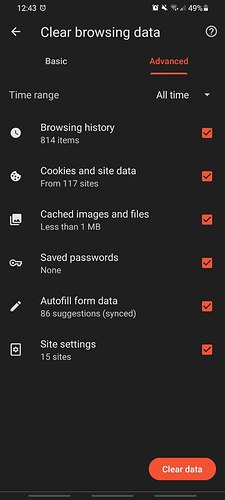

I did this
Same situation

Yes. I already tried to clear browser data and restart the phone.
Same situation
