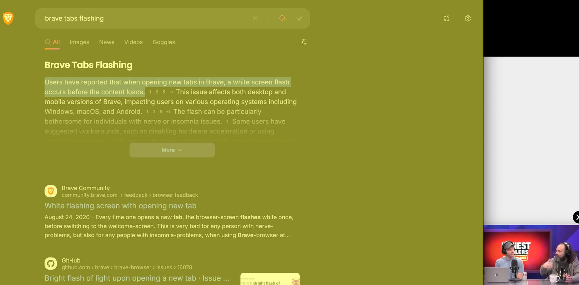

When using macOS’s Spoken Content feature, windows in Brave are covered in a translucent green overlay. The feature works by highlighting text and using a keyboard shortcut to start or stop computerized speech. So long as the computer is speaking, windows in Brave will flash with random intervals, from split-seconds to full ones. While reading long passages it will tend to get stuck on the green overlay until speech stops.
The problem persists when text is no longer being highlighted or when switching to a different tab, so long as the computer is speaking (during which it highlights individual words as they are spoken). Sometimes it is able to read with no issues, but because it only starts or stops while speaking I beleive it is definitely related. I have not had this issue in Chrome or various other apps.

Expected result:
Image is from an irrelevant search page that should have a black background with white text. Flashing or hanging on the overlay will become more apparent if longer sentences or passages are being read.

Hello, another update. I seem to have solved the issue.
  1. Go to macos Accessibility settings
  2. Go to Spoken Content and click the button next to the toggle for Speak Selection for specific settings
  3. Change Highlight Content from Words to None
I’m not sure if this option was around on Ventura, but either way changing it as above solved the problem.
In other words, the flashing is somehow related to the computer highlighting text during speech (a seprate kind of highlighting from simply selecting text). I think proper etiquette will have me mark this as solved now, but there’s still some kind of underlying issue that I hope the developers can locate.
