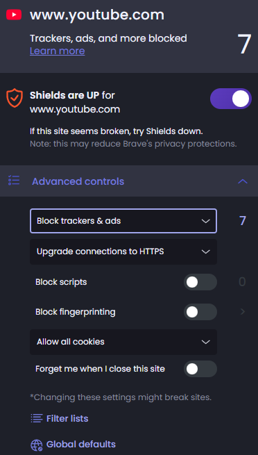

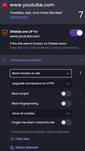

@okita can you please visit youtube.com and check the Shields settings for the site (lion icon in address bar) and ensure that you do not have it set to Block all cookies (Block third party cookies is okay) and also ensure that Forget me when I close this site is toggled “off”?
Hello Mattches, thank you for your response.
These are my settings for the shields, I don’t know if block trackers & ads may be the problem, but I didn’t have "Forget me when I close this site" enabled before, and I also checked the cookies in my Brave settings and I have them allowed everywhere too, any other ideas of what may be happening? Thank you!
:backhand_index_pointing_up: I would go ahead and change it back to Block trackers and & ads for all sites. This particular setting is not what is causing the issue.
