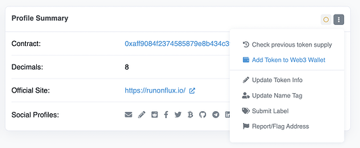

The decimals value for FLUX token is incorrectly set to 18 on CoinMarketCap (should be 8). Here’s how you can fix your issue:
  1. Click “Visible Assets” and delete FLUX token.
  2. Open the token page on bscscan: https://bscscan.com/token/0xaff9084f2374585879e8b434c399e29e80cce635
  3. Make sure you have selected “Binance Smart Chain” as the active network in Brave Wallet.
  4. Click on “Add token to Web3 wallet” (see screenshot below).
  5. Open Brave Wallet, and check the correct balance on your portfolio.
Thank you very much onyb !!
It did work! I suspected a decimal number problem but I think, I’ve just not confirm correctly the network adding operation from my ledger.
Thanks again, you saved my life !
