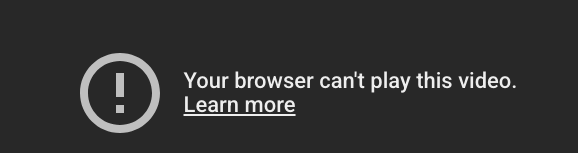

Why can't "YouTube Movies & TV" (channel) videos be played in Brave?
Every video available on this channel returns the same error message.
https://www.youtube.com/channel/UCuVPpxrm2VAgpH3Ktln4HXg
I thought it might be because of a Shields setting but turning all Shields Off yields the same result.
Something else in Brave causing it?
Widevine enabled? Settings-> Extensions and turn on toggle
@Saoiray… Thanks! That was it. I didn’t know anything about Widevine.
Nice that it can be activated directly in Brave’s ā€˜Settings’ (i.e., Google download/install not required).
Yeah, just one of those things widely used across the internet. Basically functionality in browsers to protect copyrighted materials. So like if you try to screen record the videos or whatever, it will show up just as blank video boxes. The whole prevent piracy thing.
Obviously there are workarounds and all, but just is at least a ā€œbest effortā€ thing to stop basic misuse of all those things. If not active, then they won’t let it play because it wouldn’t have the protections.
It’s stupid, but it is what it is.

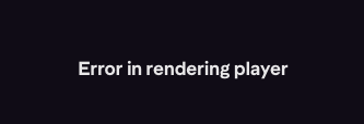

@Saoiray . . . I thought enabling Widevine would fix video rendering elsewhere, but e.g. as shown below, it hasn’t.
Do you know of other settings that affect whether videos play or display this:
This particular one appears all the time for in-line videos in Yahoo! News articles.

@mk7z Widevine would only be for the ones refusing to play the copyrighted stuff, primarily like on YouTube TV, Netflix, Amazon Prime, etc.
For issue as you’re speaking, I’m not quite sure where the problem would be. Essentially would go through basic troubleshooting steps as usual to see if any of them give clues.
Guess quick reminder on the more basic troubleshooting steps, trying each as its own independent step. (don’t do multiple at once. Revert back if no improvement)
  • Check for updates = Common sense, but make sure browser is most recent and check if everything at brave://components is good.
  • Disable Shields = to see if they are blocking or breaking anything
  • Private window to check if extensions or cookies are to blame. If it works on this, then you know it’s one of the two, at which point have to clear cookies and/or play with extensions until you figure out which is doing.
  • Second browser profile = Same as above, but more thorough. Also can indicate settings.
  • Disable Graphics Acceleration = Well, for video issues. Just makes sure it’s not a GPU compatibility problem (Settings → System is where toggle is).
  • Install/test on Brave Beta and/or Brave Nightly = Just to see if it’s version specific. If it works here but not on normal, either it’s something like flags enabled or it might be an issue that’s fixed in release.
  • Test on Chrome = If all of the above fails, good to know if it also happens on Chrome or if it seems to be only Brave having the problem.
You won’t always find the answers in there, but it seems the vast majority of problems get located somewhere in those steps. Then it’s just narrowing it down further from there.
@Saoiray… Thanks, I’ll be going through those.
I can confirm at this time that Shields down has had no effect.
Also, that the videos do play in Safari.
Your suggestions that involve browser upgrading (including Beta/Nightly) aren’t available to me as I’m limited to (and by) my current macOS, the last one supported by both Apple and Brave.
I’ll follow up further re your other suggestions.
