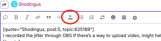

You can either upload directly into the editor using the upload button:
Or upload to a site like imgur.com then paste the link into the editor.
