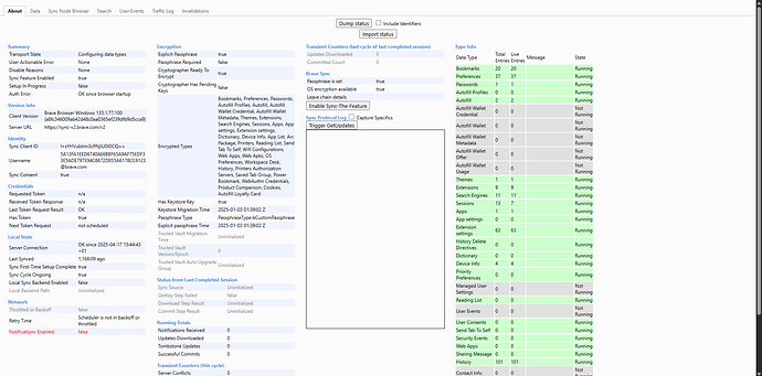

If i goto brave://sync-internals/ This is all i see. I saw in some other posts i could delete the data here but couldnt find it
I have the exact same problem on (antiX) Linux. Only Bookmarks sync, leaving sync chain does not work, sync-internals presents an “Enable” button that does nothing.
