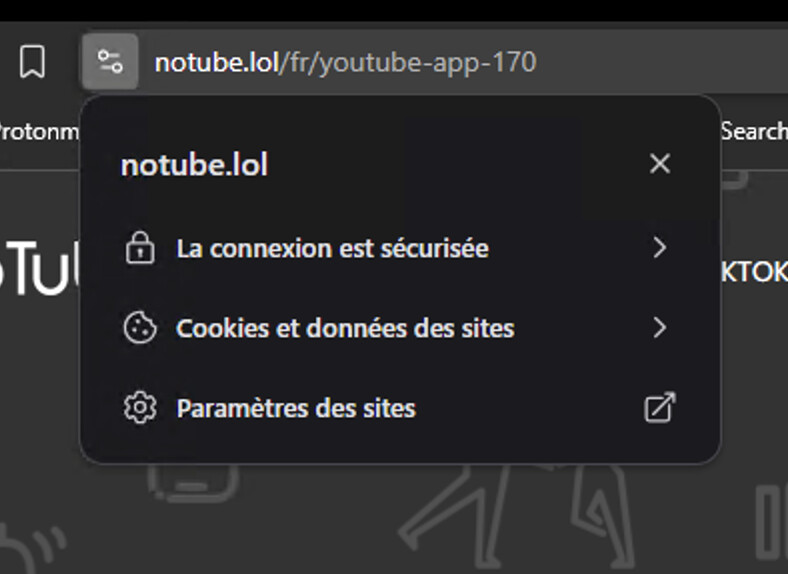

Same thing. I notice something else
On noTube.lol (where there’s no problem)

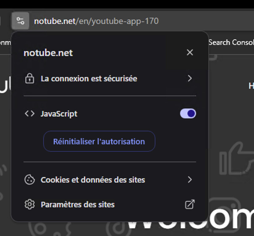

On noTube.net (where there is a problem). The Javascript line is always displayed. Even after clearing the cache, cookies, resetting permissions and relaunching Brave.
Of course, clicking on Reset authorization doesn’t change anything and the Javascript line will still be displayed.
