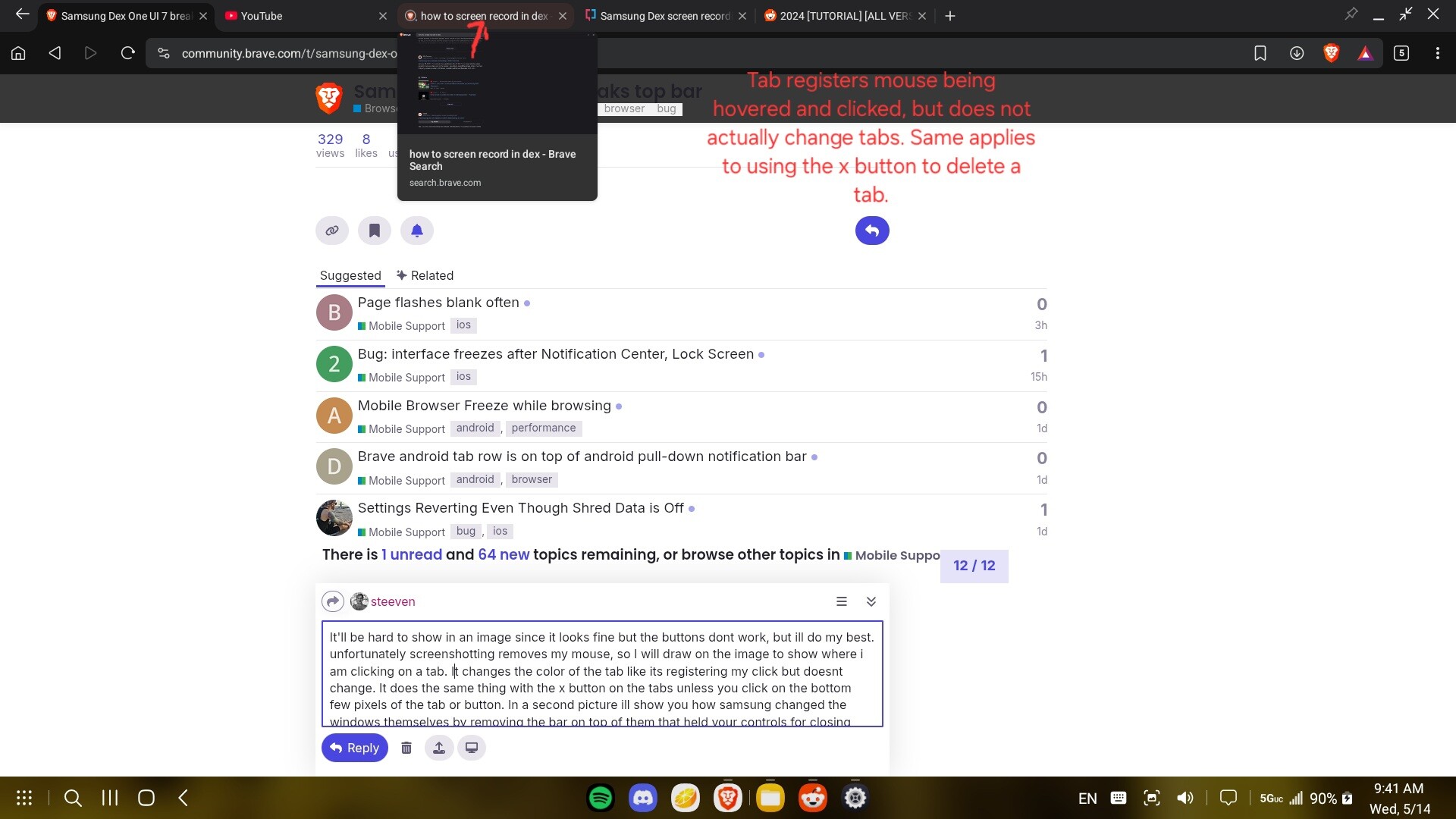

Description of the issue: Since the update to One UI 7, once you try to close a tab in the top bar in Samsung Dex or try to focus a different tab, nothing happens. The clicking is registered, as the highlight on the X or the tab dissapears with the click.
  1. Launch Brave Browser on Samsung DeX
  2. Open a tab or use an existing one
  3. Try to close it with pressing on X, or try to switch tabs with the mouse.
Expected result: Tab closes when clicking on X. Tab focuses when clicking on tab bar.
Brave Version( check About Brave): Brave 1.77.101, Chromium 135.0.7049.115
Mobile Device details: Samsung Galaxy S23 Ultra 5G EUX
Additional Information: Clicking slightly under the X closes the tab successfully, so therefore I think the button was misplaced somehow. Clicking under the tab name successfully focuses it. Opening a new tab works without issues and without the workarround.

I really have nothing to add, except that this is happening on my S22 5G in Dex.
But this also happens in Chrome!!! the same workaround of clicking just below the text works.
Speculation: the bounding box for the “titlebar area” or whatever it’s called in Android is set wrong, and it’s overlapping the tabs (as an invisible “window” or whatever Android calls objects).
This is also happening with me. It’s really awful. Cuts down my productivity. I’ve been using Ctrl+Tab to get to different tabs and Ctrl+W to close them, but it’s very tedious.

Just recieved One UI7 / Android 15 update on S21 Ultra (exynos)
  • same thing is happening in DEX now,
    clicking slightly lower works for both accessing and closing tabs.
  • on the plus side i think hovering the mouse pointer over a youtube video in desktop mode interacts with the navigation bar more often and more reliably than before.
EDIT: it happens on chrome as well so not a brave exclusive thing
Just made a Brave account to keep this thread going. It appears that the new ONE UI 7 has broken most browsers on Dex. The buttons for closing and switching tabs are misplaced as it seems that the UI changes removed the standard lip on top of the tab that allowed for closing or changing the size of the app window. This then moved those controls down into the same bar that has the Brave tabs in it, thus blocking our inputs to reach the buttons (which is why you can just barely touch the bottom of the X button but not the rest). Brave will likely have to extend the Brave tabs down a bit further and push the buttons down with it to solve this issue as Samsung will almost certainly not address any issues with Dex as they have pretty much decided to leave it in its current state forever. Hopefully this is resolved soon!
Strangely enough, you can click anywhere on the new tab button and that still registers perfectly fine, so it may just be something with specifically the buttons for closing a tab and switching tabs. Wack
