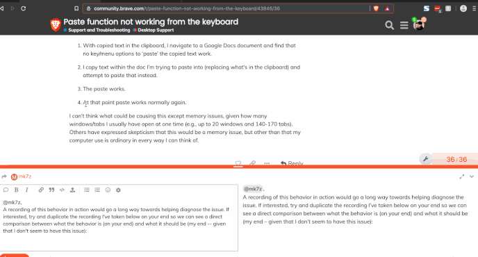

This issue continues in an apparent stalemate. The ‘fix’ (kludge tho it is) always works. The sequence is:
  1. With copied text in the clipboard, I navigate to a Google Docs document and find that no key/menu options to ‘paste’ the copied text work.
  2. I copy text within the doc I’m trying to paste into (replacing what’s in the clipboard) and attempt to paste that instead.
  3. The paste works.
  4. At that point paste works normally again.
I can’t think what could be causing this except memory issues, given how many windows/tabs I usually have open at one time (e.g., up to 20 windows and 140-170 tabs). Others have expressed skepticism that this would be a memory issue, but other than that my computer use is ordinary in every way I can think of.
@mk7z,
A recording of this behavior in action would go a long way towards helping diagnose the issue. If interested, try and duplicate the recording I’ve taken below on your end so we can see a direct comparison between what the behavior is (on your end) and what it should be (my end – given that I don’t seem to have this issue):
I’m especially curious if you see the message at the end about Google Docs Copy/Paste functionality.
