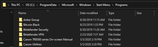

Can you check the C:\ProgramData\Microsoft\Windows\Start Menu\Programs directory and tell me if you see Brave here?
@Mattches quote=“Mattches, post:10, topic:131910”]
[/quote]
I do not see Brave at that location:
br
@hersh,
Sorry for the late reply, thank you for confirming. I’ll be digging into this with some Ads-team members so we can get you up and running. Appreciate your patience.
