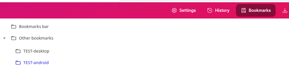

Steps to Reproduce
in Bookmark manager on desktop…
  1. create folders TEST-desktop and TEST-android
  2. bookmark site-A in TEST-desktop folder

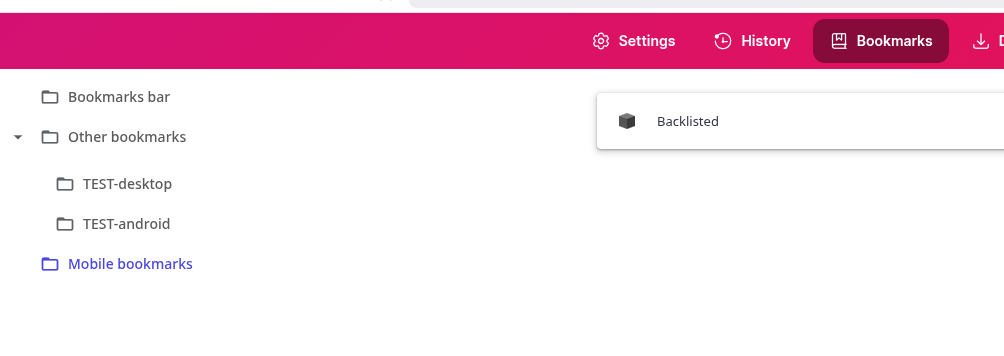

  3. bookmark site-A on synced device (bookmark appears in Mobile bookmarks folder on desktop)
  4. drag bookmark from Mobile bookmarks to TEST-android folder.

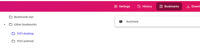

  5. TEST-desktop folder is empty

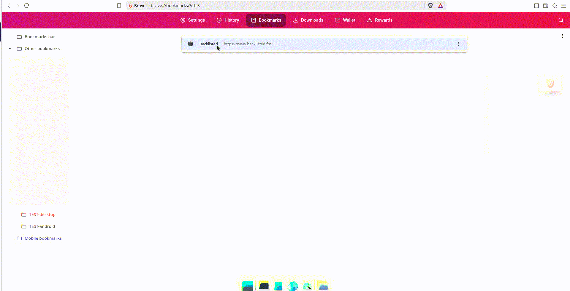

Actual Result:
GIF shows bookmark dragged from Mobile bookmarks folder to TEST-android folder, then bookmark now missing from TEST-desktop folder.
out
Expected result:
I don’t expect bookmarks to disappear from other folders when moved about in unrelated folders. I expect bookmarks to be remain duplicated except where explicitly moved. The current behaviour is a bug.
