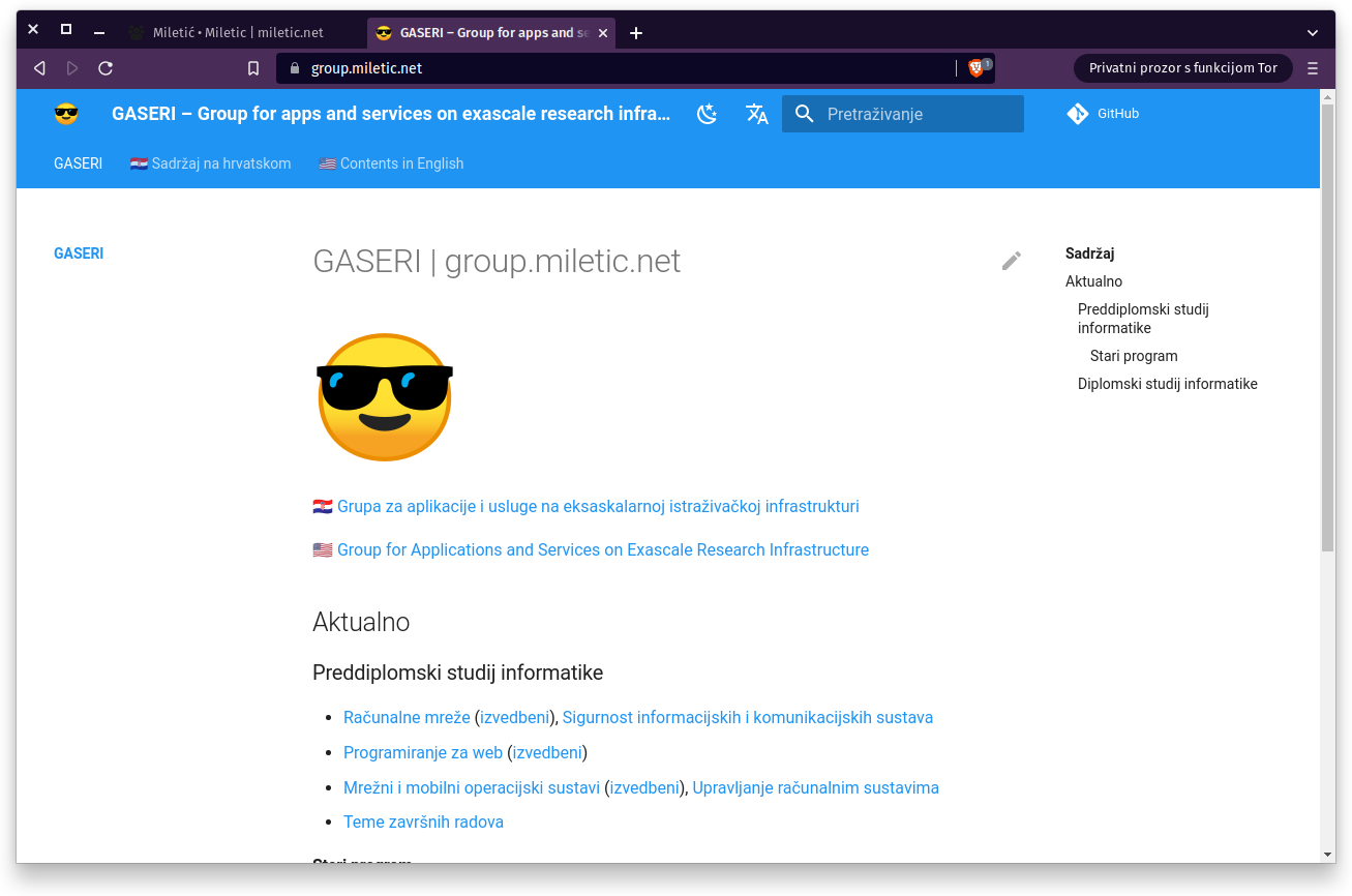

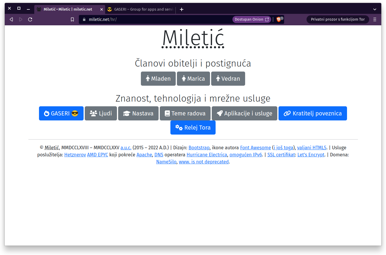

When I try to access a website with an alternate tor link, a little icon appears in the URL bar, informing the user that there is a tor link for this site, as shown in the picture below.
How can I put a similar icon to my website which has an onion link?

check this one
search for Onion-Location
and here how to config it
hope that help and have a nice day :slight_smile:

I was able to add the meta tag to the webpage and it now works perfectly fine on the Tor browser, but it still does not appear on Brave; do you have any suggestions for how to address this?

did you tried the server configuration option or you do not have root access to it
i not sure which way brave use to detect the onion so first try the server option and if you can not or it does not work
then let me ask @Mattches to help us here and maybe add the option for brave to detect the meta tag
and have a nice day both of you :slight_smile:
Unfortunately, I don’t have root access to the server so I think I’ll wait for @Mattches’s response.

i found a request in brave github to add the meta tag option
here it is
so wait till they add this feature
Have forwarded this issue to the tor team for review — @justsomeone1 is correct here in that this is the only way (currently) to make this work. Hoping to get eyes on the feature request.
