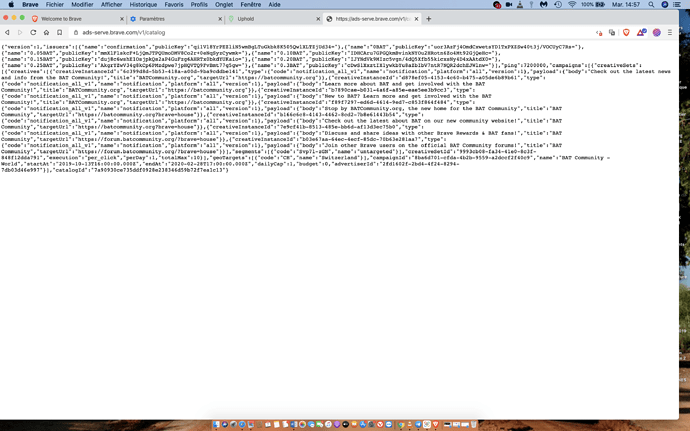

@Phillip1 Enter this catalog URL in URL bar https://ads-serve.brave.com/v1/catalog
If catalog gets downloaded then ads should be served to user. If not, then someting is wrong with settings. If catalog is empty then Ads will not be shown to user. Ideally for supported regions Catalog should get download.

Hi Geeta,
The link doesn’t work. Below you will find a screen picture to show you what the link shows.

@Phillip1 The catalog file which you posted in the thread looks correct to me. Currently, there are no ads available for Switzerland that’s why there is Untargeted ads category listed in the catalog.
