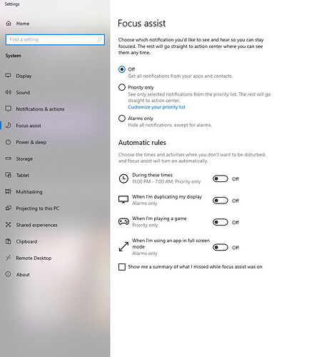

For that, it’s things like making sure you have Focus Assist completely off, including any automatic settings.
