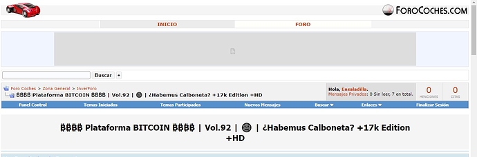

The gray banner at the top appears on many pages of www.forocoches.com, before they did not appear and with other blockers it does not. Can you block it in Brave? Thank you.

Because I just realized that it comes out only in random threads to registered users. If you are not registered you will not be able to see the code to locate it. A greeting.

I have realized from the Chrome browser with Ublock origin that when deactivating the blocker, the banner that goes in that place is text with internal promotions of the forum itself.
Ublock origin if it blocks that advertisement without leaving that empty box, but the Brave blocker for a few weeks has not. Before in Brave that internal text advertising was shown without the box, it did not block it either.
I also tried blocking it manually, but nothing.
I will continue investigating to see how to remove it.

The first 2 do not work and if I enter: .cajasprin, the content of half the forum is blocked.
This is what I get about this type of ad ad in the code of one of the random banners of the forum itself.
view-source:https://cdn.forocoches.com/lwa/forocoches/fc_promo.html?20200111
Let’s see if I can find the solution because with Ublock Origin if it blocks that advertising.
