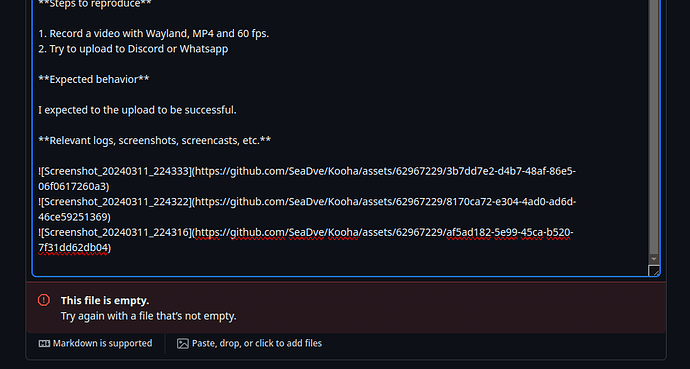

When attempting to upload videos from my Manjaro machine using the Brave browser, the platform consistently reports that the uploaded videos are empty, and the upload process fails. I think this is a Chromium fault, since Electron apps like Discord fails to upload videos too aswell.

Here’s a video demonstration:
Streamable error:
imgur error:
Can you also confirm for me that this occurs when you try to upload any video file, or is it just one specific video file?

I’ve managed to identify the root cause of the issue. It appears that the applications I was attempting to use for uploads weren’t able to access certain home folders, such as ‘./Videos’. To resolve this problem, I recreated the necessary folders, ensuring they had the appropriate permissions for write access.
