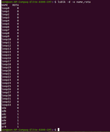

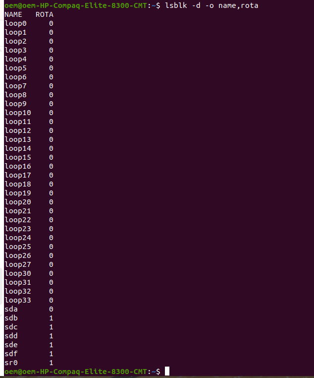

And what do you get if you run this in a terminal?
lsblk -d -o name,rota

Attached is a screen print of the results when I run lsblk -d -o name, rota.
