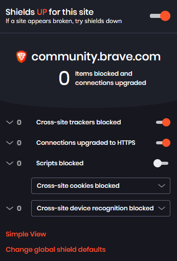

So I’m not seeing this behavior on my end. Embedded videos on Reddit seem to play as intended. Can I ask what you have your Shields settings configured to for Reddit?
I’m seeing this happen with and without brave shield. And in incognito.
