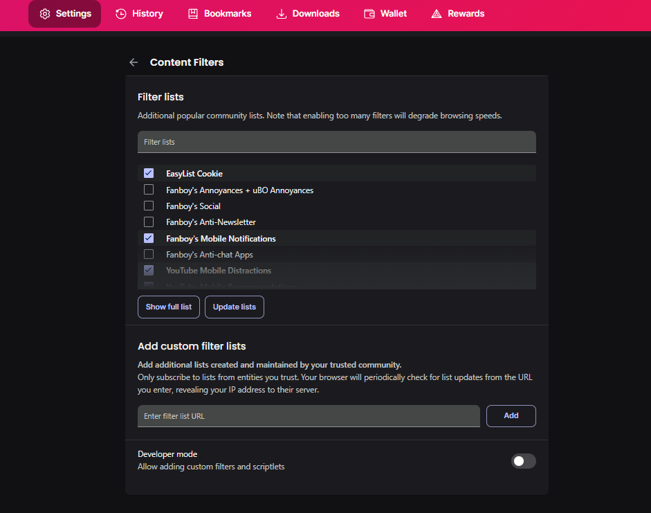

Okay so As far as I know when you enable these content filters from the dedicated menu they are supposed to block off certain parts of certain websites
But even after so I can still load shorts on YT.
And also I want to add custom filters of my own, to block of facebook and instagram reels. Someone pls let me know how I can do that. But for now I’m not even able to block off the contents that are included in the list.
@15r4r to start, I can’t see all the options you have selected in the filter lists – it looks like you have EastList cookie, Fanboy's mobile notifications, Youtube Mobile distractions and Youtube mobile recommendations.

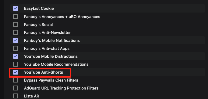

For removing shorts, you should also select the specific filter Youtube Anti-Shorts:
If you do not have this one selected already, please do so and you should no longer see shorts on your feed. If that doesn’t work or if you already had it selected let me know.

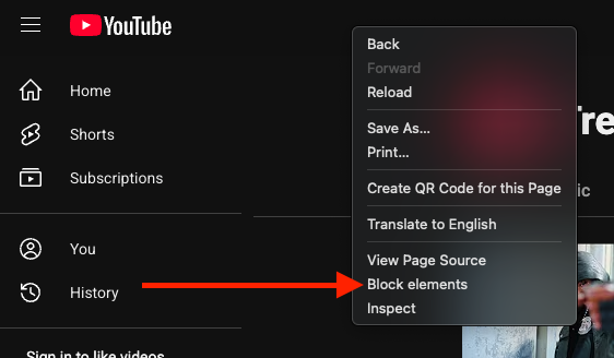

You can start the element blocker by right-clicking on any page and selecting Block elements. Your cursor will change into an “element selector” that highlights different elements/sections of the web page you’re viewing. From there, it’s just a matter of finding the right elements to block.

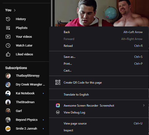

I’ve got Anti-Shorts selected, and lists are updated. Still not working. Having to use another 3rd party extension to get rid of it. And Thank you for the video by the way it helped. But that right click menu doesn’t even show “Block Element” option on the youtube website.

and yes, I do not see any block elements menu, and that is only for youtube and discord. and it working for other websites.
